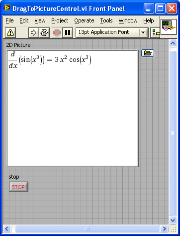

In cases like this I often resort to using a transparent classic path as an overlay to catch dropped files.  If you do not plan on interacting with the picture control, it is quite easy.  Otherwise it is just a few more events to control visibility when the mouse enters the VI with the button pressed.
Just run the VI and drag PNG, JPG, or BMP files to the picture control.
