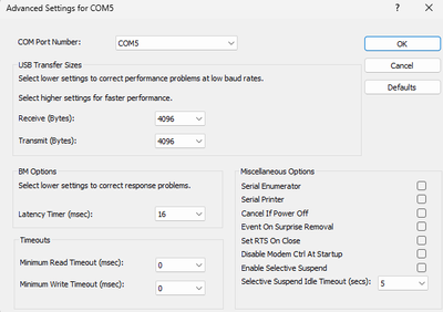

I did not roll back the windows but writing the question gave me some clarity and that led me to read about "latency". I tired to see what the read latency was for my device under windows settings:
Go to device manager and navigate to Ports(COM & LPT):
Right click on the port of your interest and select properties:
Go to port settings & click on advanced:
Set Latency value to a value of interest: (mine was at 16ms so I changed it to 1ms)
This seemed to have solved my problem, for now. Now I need a way to be able to programmatically change it. I will keep testing to see if this was just a fluke or an actual fix. I will keep you posted.

I can confirm latency setting was the culprit in my case. I could replicate this across multiple machines and devices running Windows11 or Windows 10. There are some more settings that might have also changed but I do not know what they originally were. For example: Selective Suspend Idle Timeout (secs): 5. I would set it higher in my case.
In my case of FTDI drivers, I used their own VI "FT_Set_Latency_Timer.vi" to change this setting through LabVIEW itself.
I hope your case has something similar/ simple going on.
