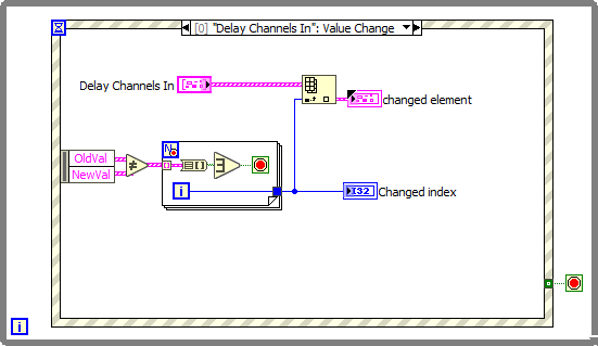

First you said you wanted to know which culster (i.e. array element) was changed, later you said you wanted to know which element was "moused".
For a value change, here's what I typically use with arrays of mixed clusters:

The reason that I suggested a mouse-down to select a cluster to edit with another VI is that some of the cluster elements are strings. They give an event for every keystroke if you use Value Change events.
The suggestion to use a Multicolumn Listbox is interesting also. There is a Focus Row property that can be used to index the correct cluster, if I can just figure out how to use a Multicolumn Listbox. I had not heard of them before today.
(4,073 Views)
Accepted by topic author StevenHunter
@StevenHunter wrote:
... some of the cluster elements are strings. They give an event for every keystroke if you use Value Change events.
Only if they are configured to "update while typing", though.
