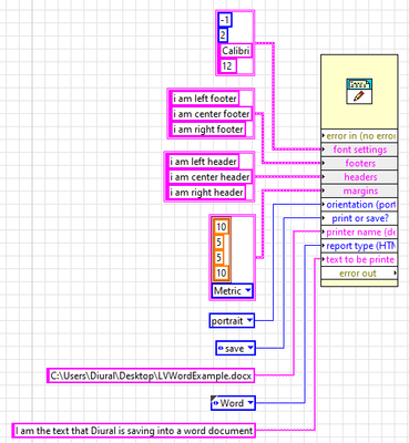

Hey Gerd,
Thanks for answering, but I just can't get a hold of an answer. I have created a word document with string input but cannot find how to just convert it to a pdf and save it as is. I am attaching my vi so far (LV2012). Thank you for the help and sorry for the question which seems like and easy one (not for me).

Hi Diural,
in the RGT palette you will find a PrintReport function, and there is a QueryAvailablePrinters function. When there is a PDF printer on your computer installed then it's easy to print to PDF.
Another option is to use ActiveX (which RGT is using under the hood anyway) to directly command Word to "SaveAs" PDF document: example found in this LabVIEW board

The report generation toolkit does not support PDF directly. Generating PDFs directly and/or completing PDF forms is possible, but not without additional libraries.
What are your requirements for the password? Printing to PDF is the simplest way to convert a Word (or other) report to PDF, but you may be somewhat limited in the ability to set a password depending on the print driver.

if you have the Report Generation Toolkit (RGT) and create a word report, you can use Darren's nugget (https://forums.ni.com/t5/LabVIEW/Darren-s-Occasional-Nugget-05-13-2014/td-p/2847152 ) to save the report directly to a PDF file.
If you have LabVIEW2015 or later the needed changes are already in the RGT.

There's also Carya's PDF toolkit.
I haven't used it much but it has more functions than just converting to PDF, might have the set password function too.
wiebe@CARYA knows more about it.

The PDF Toolkit can PW protect PDF's.
Carya Automatisering | Products
