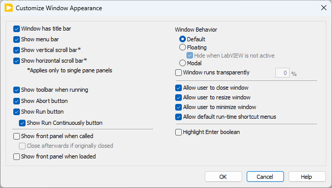

I have a VI I'm trying to modify
When I press run the front panel comes up in the run only mode.
I want to turn that off- how do I do it?

Check VI properties..windows appearance.
(Set it back to default or change your current customization.)

VIs have "Properties".  Open your Top Level VI, right-click on its icon in the upper right corner and choose "VI Properties".  Make the category "Window Appearance" and choose "Custom", then press "Customize".
Look at the options on the left.  If you turn off "Show Abort" and "Show Run", you won't be able to see these controls on the Front Panel.  Is this the cause of your problem?

Okay thank you everyone that was the answer
In this case, it seems "show menu bar" and "show toolbar when running" were turned off. (If the toolbar is not shown, the visibility settings of these buttons (abort, run, etc.) is irrelevant.

During development it should be left at the defaults. Once you built a standalone application, the toolbar should not be there and the menus should be custom.
