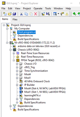

I am working with NI Crio and Arduino. I have sensors connected to Arduino, this Arduino is connected to Crio, and it sends data serially to Crio.
My Labview project for this includes 3 VIs: one VI on Windows, one VI under the Crio RT target, and the third VI under Crio FPGA target.
The FPGA vi controls some thrusters, the Crio RT vi has the code for fetching data from Arduino, and the VI on Windows merges all the data together and I've also made the GUI on it. This third VI has some shared variables too since there are certain commands which the user can input through the GUI. Those commands have to go to the other 2 VIs.
I want that when I open the Labview windows VI, all other VIs in the project start running automatically.
Right now, I have to open all the 3 VIs and run them separately, otherwise, the shared variables wouldn't work.
I thought of converting the VIs under the crio RT and FPGA targets to subvi and including it in the Labview windows, but that wouldn't work would it? because the targets are different.
How can I do this?

The main VI that runs on Windows is by the name 'Host Program'
The Crio-RT program is 'send aruino data on labview(GUI recent)'
The FPGA program is 'learning9474'

First, thank you for attaching the Project view, showing that I was correct and you really are running a LabVIEW RT system with three processors, Host (PC), Remote (cRIO), and FPGA.
@billko pointed out something that I overlooked, so I apologize, and will try again.
As I understand it, what you want to do is the following steps:
  1. "Turn on" (or leave running) the cRIO.
  2. Turn on the PC.
  3. Start program on PC.  Have PC "automagically" connect to running program on cRIO which has automagically connected to code running on FPGA with you doing nothing more than possibly waiting for a few seconds, particularly if you need to actually "turn on" the PC and start Windows.
Here's what you need to do:
  • Configure your LabVIEW RT program on the Remote to start the FPGA code running shortly after the Remote starts running.
  • Have your Host and Remote start some form of "hand-shaking" protocol (not unlike establishing a TCP/IP connection) to "find each other", typically by IP address.  Generally I've done this making the assumption that the Host knows the Remote's IP (which is usually fixed), so can "ping" or something like that to find it.  I use Network Streams when dealing with LabVIEW Real-Time, so I configure the Remote to "Listen" for a connection and the Host to try to initiate it.  Since I "expect" the Remote to be on-line at a fixed IP, I set the Host to try to connect, with a 15 second timeout, and if it fails three times (45 seconds), it "gives up" and says "Remote not found" or words to that effect.
So by the time the Host is ready to run the program, the Remote and FPGA code are up and running, and all the Host needs to do is "reach out and connect".

I do the same except I use the low level TCP primitives.  I just never became a fan of the Network Streams.  I used to really like the STM library, but more recently found it too restrictive and have made my own library similar to it.
So to reiterate the solution:
1. You make a build for the cRIO RT.  If you have it loading the FPGA, that will be taken care of for you.
2. Load the cRIO build onto the cRIO and make it "Run at start".  Reboot the cRIO to complete the deployment.
At this point, the cRIO will always be ready for you and you will only need to start your Windows VI.
