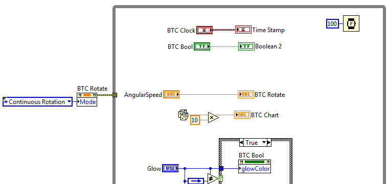

I wanted to mention that we are in process of packaging/finalizing our Pebbles UI toolkit for LabVIEW, one of our special functionality component is a Rotation Control which does exactly what you're wanting to do:
http://www.batchtest.com/pebbles-ui-for-labview/
Our Rotation Control is shown on left side of the VI image, it accepts two images - one for background and another for rotation. Currently it can accept vector graphics (.SVG, .AI) and bitmaps (.PNG, .JPG, .GIF).  If you don't set a background image, by default things are transparent.  It rotates your graphics by a fixed angle that you specify, or it has CW/CCW continuous rotation depending on angular speed you specify.  Our graphics engine uses hardware acceleration and runs in a thread separately from LabVIEW, it writes directly on LabVIEW screen.
Unfortunately we're not done packaging the toolkit (LVTN requires quite a bit of testing and documentation for a release) so it won't help you at this point but please keep it in mind if you have a future need for rotations on LabVIEW front panel.  If you are local to Silicon Valley, there will be a live demo at Bay Area LabVIEW Users Group (NI location in Santa Clara) next week - Feb 10 where you can see it yourself.
-BTC
(A map image is set as background in this case, can be omitted for complete transparency. The needle with red tip rotates on it, silver round border can also be hidden through property nodes, on wire diagram it comes  up as a numeric/double indicator).
Here's what it looks like on wiring diagram:
New Controls & Indicators made using vector graphics & animations? Click below for Pebbles UI
