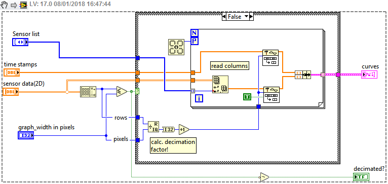

Since I have some time, I decided to clean up/revise some of my VIs in some of my projects. I use an action engine to store sensor data (columnwise) along with absolute time stamps. The data is generated with 1Hz, and I only need to store 2 days of data (172 800 values per channel). My code works as intended, and using a simple banchmarking, a data insertion + Graph curve read out operation together takes roughly 60 msec. This is just fine for me, because I only call this AE at two parallel loops: at one place I insert the new sensor values, and at the other I read out selected curves (max 12) between the user specified time stamps. Both loops iterate with 1 Hz.
The AE is called: "Data_storage_AE.vi". The VI where I decimate (average) the data curves to be less than the max horizontal pixel size of my Graph (I do not want to plot more points than the number of pixels): "decimate _for_curves.vi".
The code works well, but I would like to fix the Rube-Goldberg parts, and also to gain some speed if possible. I have some changes in my mind, and I searched such topics in the forum, but I thought the best is to show you people the VIs (I zipped up the relevant VIs/Ctrls from my project, version LabVIEW 2017) 🙂
I am looking for optimization mainly at these locations:
  1. Decimation VI: Could this code be improved to gain more speed?
  2. "Data_storage_AE.vi":
    1. I need to fix that stupid "delete 1 hour of data if array size reached 172800" 🙂 Circular buffer is in my mind, I wonder what could be a useful construct here. I could even imagine a Queue with Queue info/Lossy Enqueue. Or better to stay with Arrays?
    2. "Read_out_interval" code seems not too optimal. Any thought to improve it (my Time Stamp array is naturally sorted in ascending order)?
    3. Buffer allocations. Where could I improve?
Thanks for any advise, I am willing to learn! 🙂

I use Graphs, but I guess it is not relevant whether Charts or Graphs we use for this question. I always thought that throwing large data arrays to a Graph will slow it down. I need to update the Graph with 1Hz, so I still imagine, for example 172800 X 12 channels data points could slow down the GUI? That is the reason I decimate my data. I will test this behaviour later!

I inlined the decimation subVI, i do not see too much improvement, but I am a noob in benchmarking 🙂

Thanks Ben for your thoughts! I also do not see difference in speed either using parallelized FOR loop or not in the decimation subVI. I guess the LV compiler is already smart enough, to do optimization behind the curtain...
What I will test, what happens if I redraw 48 hours of data, 12 channels at 1 Hz in a Graph. I imagine it will slow down things...?

For my actual application it is just fine, but I really like that I learn some new things via even a "not necessary" improvement 🙂
I also found this interesting discussion: https://lavag.org/topic/16931-queues-vs-ring-buffers/?page=2
And I will play with this data ref approach: https://forums.ni.com/t5/Example-Program-Drafts/New-Variant-Ring-Buffer/ta-p/3513140
For the second link, note that, it looks like an older version exists in the VIPM, but as I see the only difference is that there are polymorphic VIs under the unpublished VIP version...
The problem here as I see, that this Addon only accepts 1D (variant) arrays. But I could just use an array of such data refs, so all sensors (data columns) and the time stamps (one column) would live in an individual data ref buffer. This might be even more efficient than using a 2D array: I only operate (decimate, etc) on those channels (1D ring buffers now) which the user selects from the 39 channels.
Hmm, I will put together some test tomorrow....
edit: so i will start something like this:
Message 7 of 23
(5,627 Views)
Of course that double array data type is wrong at the top left FOR loop. It must be a single double constant.

By the way, I did a stupid thing in that decimation VI (see my first post, last snippet): I calculate the decimated array from the Time Stamps array N times inside the FOR loop! Stupid me! 🙂 It is enough to calculate it once outside the FOR loop, since I use the same time stamp array for all XY curves 🙂
