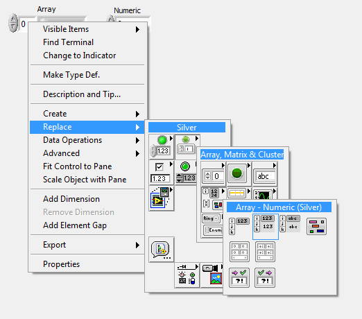

Trying to replace an old style (non silver style) array of Numerics by a shiny new "Array - Numeric (Silver)" does not preserve the Numeric representation and casts it to DBL, no matter what its original representation is:
Note that replacing a single Numeric control by a Silver style numeric preserves the representation.
Tested in LV13 SP1 64bits (Windows 7).

To tell the truth, I'm surprised that the one you said works does. I have always assumed that when you replace a numeric, it resets the datatype. Always seems to for me...
