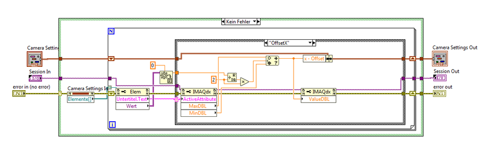

so i am trying quite some time now to figure out a problem with my code regarding reconfiguring an IMAQdx continous acquisiton. What i want to do is draw a ROI and crop my acquision to this ROI.
I got a routine figured out for this, which is working perfectly if i use the settings cluster and type the right settings into Camera Settings. But if i use the ROI calculation, which calculates correctly, for some reason IMAQdx Active Attributes gives me 0 as MaxDBL and MinDBL incase of OffsetX and OffsetY, therefor my frame always is in the left upper corner.
Attribute configurationAttribute configuration
If i draw my ROI and manually update one value in the Camera Settings cluster afterwards it takes the right ROI right away.
Somehow i struggle even explaining the problem 😉 Basically i do not understand what the diffrence is between updating it by writing values into the cluster or calculating the values via a ROI and using these calculated values and why does this affect my session attributes?

I took the time today to rebuild the VI as a simple example of how i am taking my pictures and uploaded it, so you dont have to look into the hole module.
I also included some hints for a better understanding of my problem.

As always the problem sits behind the screen 😉 I did not make sure that the new width and height are set before the offsets are set, therefor the offsets min and maxdbl are 0 -  camera is in full width and height.
Simple solution:
Reorganize the settings cluster, so that width and height are on top and will be processed first and a shiftregister for the session in the for loop.
