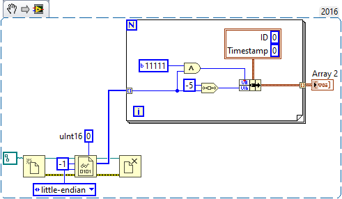

The short, broad question: is there any way to work with a binary file bit-wise, instead of byte-wise? Or, alternately, to use a custom data type with "read from binary file," which is not a full byte long?
The explanation:
I have data from, in essence, a counter. It dumps binary files in which each event has information encoded in a word of N bytes. However, subsets of information are not necessarily a full byte, nor are they "aligned" to bytes. (For the record, I can't change the data type)
A concrete example, slightly simplified but effectively identical: A word length is 2 bytes. In this word, the first 5 bits are an ID number, and the remaining 11 bits are a timestamp.
01101  11111000000
ID         Timestamp
I am trying to quickly parse this file, creating an array with the information.

You don't show what you did with the first solution, but most likely you used numeric to bit array and all such shenigan. Instead use boolean logic and Rotate!
If that is still to slow for you there is nothing that will be faster except going to FPGA!
This is simply to give you an idea. You didn't specify the actual format on disk (Big Endian or Little Endian, Upper 5 bits or lower 5 bits for the ID, etc).

Thank you! I will give that a shot.
The data is little endian, which is part of the problem but not insurmountable.
(5,497 Views)
Then use the Read Binary File node with the byte order input set to little-endian.

This is looking like it might be the solution! Thank you. I will confirm as solution when I am sure that it is working. What is represented by the little "b" in the corner of your constant / how do I create it? I assume it's something to do with designating a binary representation? My code seems to be working without it.
I would never have suspected that boolean "and" worked in this manner. Thank you!

Right-click...visible items...radix.
On a side note, you don't even need a FOR loop (but it is slightly less memory efficient. If you want, insert a toU8 into the upper branch):
