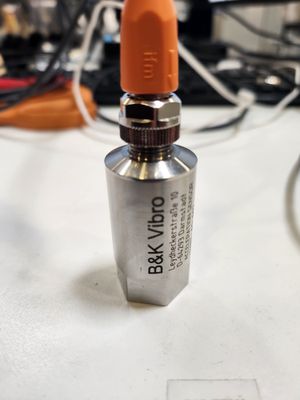

Hello community. I am new to accelerometers and  am trying to measure vibration on rotating equipment. I have a B&K Vibro accelerometer (datasheet attached) . I connected it to an NI9230 and was able to get a signal out of it. Although I am not able to understand how to interpret what I am looking at. I would expect g values to show on y axis and show a constant ~1g when my accelerometer is vertical. Although what I see is values close to 0. It does respond to vibrations but I dont understand what I am looking at on the y axis. Do I need to scale the sensor readings? It does take 'g' as unit by default though.
Any help is appreciated! I have attached relevant snapshot.
The acceleration due to gravity is "constant". If your accelerometer reads it, it measures a constant DC voltage. However, your accelerometer is AC coupled, which means it blocks DC voltages. That is why you are not seeing a constant of 1 g.

Thank you for the response! Your answer prompted me to search AC coupled accelerometers and I found this which makes perfect sense to me now.
Although I am still wondering what are the values I am seeing on the Y axis then? Is it just the amplitude of displacement of the vibrations then? How do I interpret that?

You set the scale and conversion in DAQ Assistant, so the Y-axis should be units of g. This assumes the calibration is correct and the accelerometer was not damaged when dropped. The units of the Y-axis are always going to be g if you use the same settings in DAQ assistant. Mostly likely your accelerometer has a frequency dependent response curve, in the calibrated frequency span, the response is ~100mV/g. If 1 Hz is in this span, then it has the same response, if 1 Hz is outside of this span the response may be lower or higher, that is, 100 mV may not be 1 g. You need to look at the literature that comes with the accelerometer.

All sensors I saw from Bruel&Kjaer (now HBK) came AT LEAST with a (production) calibration certificate (at least one frequency point).
The spec of your sensor say 100mV/g +-10%  and another +-10% in the frequency range 1.5Hz to 10kHz.
So without the individual cal-sheet value you can expect  10%  increasing to ~15% (20% worst case) to the lower end (High pass filter 0.5Hz) and higher end (resonance effects) of the frequency range.
With a calibration in the frequency range (usually 1/3 octave) you migth come down to 1-3% (depending on the cal-lab)  ... if needed.
Kodos for the well documented question!
