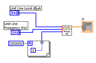

Thank you for the fast replies from you guys. I attached my VI.
My problem is based on the graph i had. How do i get data for 20k based on the graph? I understand that the array to generate this graph do not have the data in the array. How should i go about doing this? Hope someone enlighten me.

You can interpolate to find points in between the ones you already have:
The output array, yi, will be 2,000,000 points.
You can index the array, at 20,000 as you said, to find the y-value.
You an do the same for any value you would like to find.

Hi Cory,
I can't get 20k for the value of 43 based on the block diagram.

When I used the code I posted above, when I entered an x-value of 20,000
I got 41.444 back. Is that correct or no?
