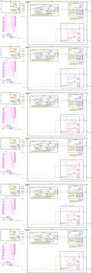

I am running a program with 6 serial ports working in parallel. I have similar issue of read / write  with RW error sometimes. I am attaching the main VI as well. Can you guide me on this.

I had a look at your VI. You have huge problems with your code, I really advise to take some tutorials or training, so you can design a proper scalable code for your application.
Your block diagram is just way too huge! Besides, why do you use Timed Loops for serial communication? It does not make any sense...

I did not load all of the subVIs, just the main one (just wanted to see the main vi). Attached is a 2892 x 8682 snippet. Smiley Surprised

Well that's 6 copies of a example vi that could have been launched asynchronously with the correct Timed Loop Name, VISA Session and Node inputs wired to the connector pane.  (remove the stop buttons, name the the loops and stop them remotely):smileywink:
