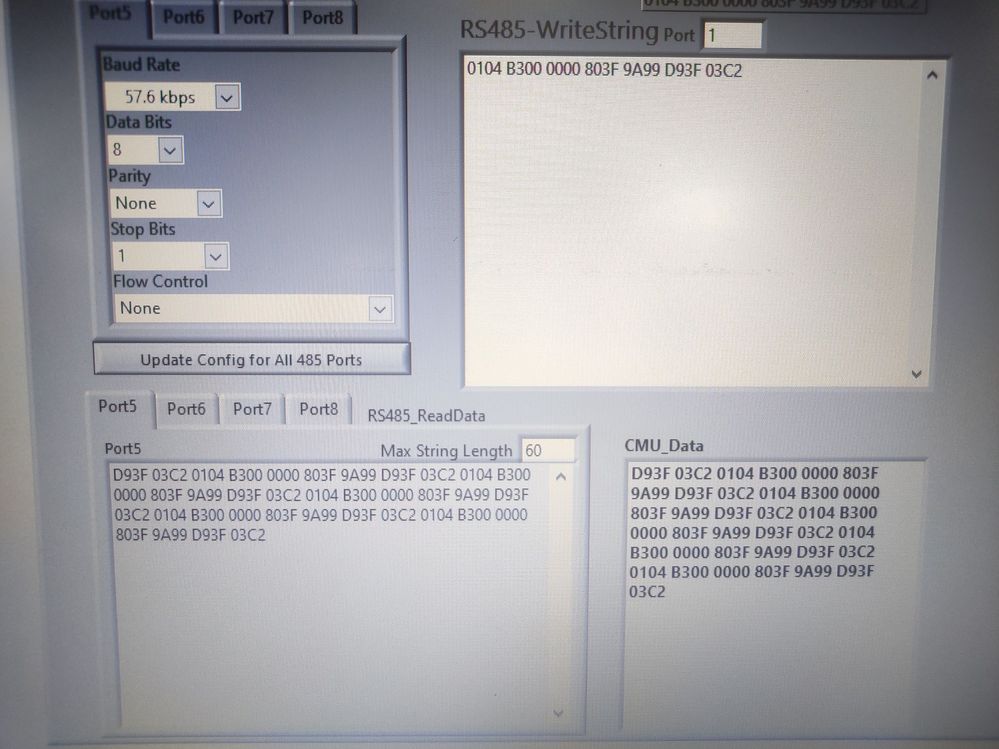

I am facing some issue in RS485 2 wire communication. I have NI cRIO9045 with NI9871 Module. I have use Port 1 of this module. For two wire communication i have short(RX+ and TX+) and connected to my testing device A Data+ and short(RX- and TX-) and connected to my testing device Pin B Data-.
I have configure Port and write IMG_20211013_121406.jpgprogram in LabVIEW FPGA. But which command i request i got same command in response.
Please guide me how can i get right data.

With a plain 2-wire RS-485 port, you may receive an echo of what you send. This happens if both TX and RX are always enabled.
Usually there is a mean to suppress this echo, either by dip-switch or a configuration software.
The corresponding mode is often named NO ECHO or AUTO. Read the NI9871 documentation to know how to set it.

Your wiring on the NI-9871 side seems to be correct.
But I am not sure about the other side. According to standard convention Data+ is B and Data- is A, so be careful. Line A is the negative part of the signal (to be connected to RX-/TX-), Line B is the positive part (RX+/TX+).
It also might be useful to use the termination resistor of 120 Ohm.

Hello .
I have configured NI 9871 Module 2 wire configuration. In device have Two Pin A and Pin B. So i have connected (RX+ and TX+) to Pin A of the device and (RX- and TX-) to Pin B. I also connect both sides with 120 Ohm resistance.
But now no response, I am not receiving a single data bit.

@amit01 wrote:
Hello .
No, no, no - you already gave me a kudo, so connect A to RX-/TX- and B to RX+/TX+ !!! As I already wrote, if you have no further documentation that says otherwise, Pin A by convention is the negative line, Pin B is the positive line in 2-wire RS-485.
Also it might be easier to use the 9871 module in scan mode by installing the appropiate software package, because you can then use this port with the standard VISA-Read/Write VIs.
Regards, Jens
