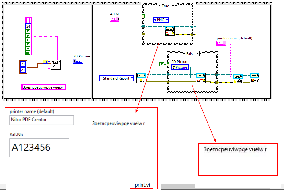

I am looking for a print directly from LV to a Zebra label printer. Requirements:
  • good qualitiy (will include QR code too)
  • directly to a printer
What would you suggest?
I've been trying this:
left side: how to get rid of the vi title at the bottom?
right side: poor quality and the size of the font (configured with 24) does not affect.... any ideas especially about the quality? anti aliasing would be good.
or are there ways recommended? any help appreciated.
thanks in advance

Don't try to print directly to the label printer from the report toolkit.  Use the Zebra software to design a label.  From there you can output EPL or ZPL code to a text file.  This is the code that you can send to the printer that will print your label.  Take this code file and add tokens for the variable information.  Save this code in your project.  When you need to print a label, replace the tokens and save the label code as a temporary file.
You will need to have your Zebra printer shared and give it a name.
Using the System EXEC VI, you can copy the temporary file to the printer using the printer share name.
cmd /c copy %filename% \\%computername%\%printershare%
