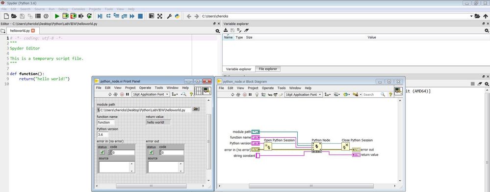

I am trying to use the new native support for Python in LV2018.  I have Python 3.6 installed and have added the corresponding DLL to the path as indicated in the LV documentation.  I am able to open a Python session using the "Open Python Session Function" node and close that same session using the "Close Python Session Function" node, all without errors, which feels like a big enough accomplishment at the moment.
When I try and actually use the session with a Python Node to run a function that is built-in to Python (print) I get an error:
Error 1667 occurred at Python Node in pythonTest.vi
Possible reason(s):
LabVIEW: (Hex 0x683) The specified Python module could not be imported.
Module Path: C:\Python36\python36.dll
Function Name: print
Python returned the following error: <class 'ModuleNotFoundError'>
No module named 'python36'
In the example above I set the module to the Python DLL.  In the end, I'm not really sure what to set the module so that I can print "hello world!"
I'm effectively trying to run:
print("Hello World!")
Just to so that I know I have a decent starting point.
Does anyone have any advice?

Hi Steve,
I defined a simple function that returned the string "hello world!", saved the function in a .py file, and provided the file path to the Python Node.
Hope this helps!

Hi Chad,
I realize my mistake now.  I was thinking that I could pass individual lines of Python script to the Python node and it would run them.  I see now that it can only execute functions from within a module.
Thank you for the detailed answer,

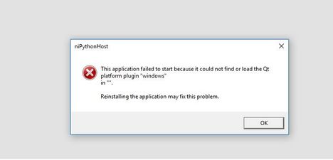

Thank you
I changed the path in the windows variable and now it works. I have next problem with matlplot lib :).
You used the command matplotlib.use('Agg') in py file generating image without having a window appear.
When running a program without this command, Labview generates a QT plugin error in windows.
I need to open graphs in external window like in the python interpreter.
Do you have any idea how to solve it ?
Thank you
