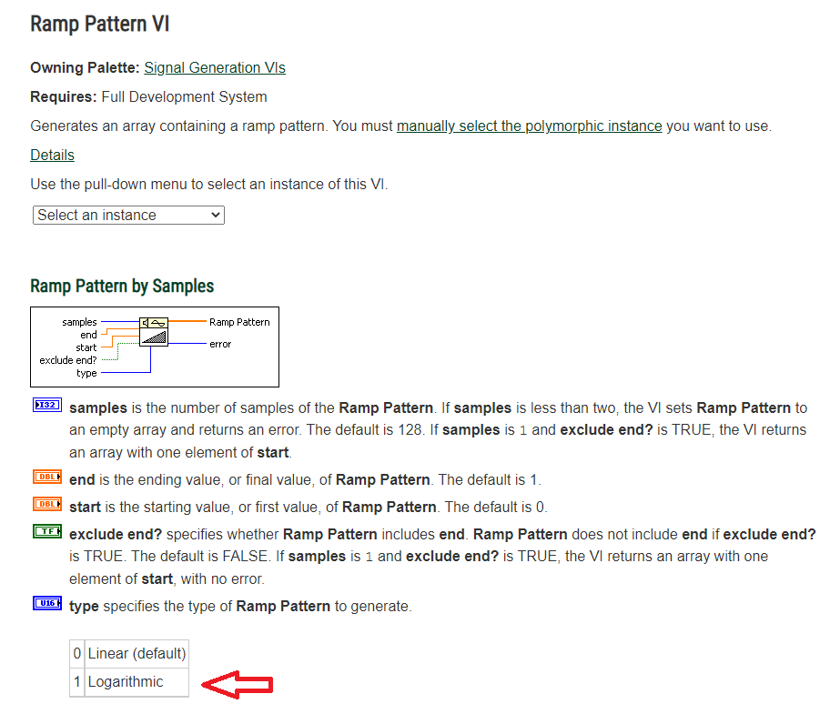

Note that ramp pattern has a type=logarithmic option. Maybe that's all you need. 😄

Accepted by topic author StevenD
@StevenD wrote:
IE user wants to start at 1,000, end at 100,000 with 3 points, the entries 1,000, 10,000, and 100,000 would be generated for logarithmic, and 1,000, 50,500, and 100,000 for linear.
Good enough? Once you make the type a control, the type (lin or log) can be selected by the user.
