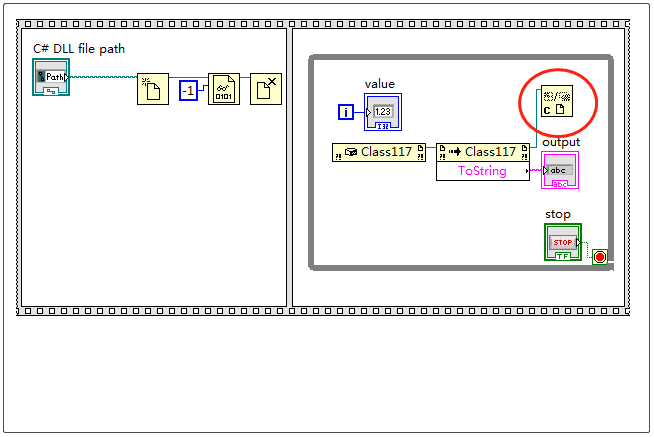

I made a complex funtion(it is no matter about my problem) by C# and build it into a DLL(assemble),so as to be called by LabVIEW.
Then I use the CLR node in diagram pannel to call the C# DLL,see as below:
but it seems that once I called the DLL, I can not the read it it by binary file. The phenamenon is that if I run the vi twice, error appear from the binary file READ block ,indicating that "the file is already open". I suspect that I need to add a CLOSE method, see as below:
3.pngBut nothing helps.

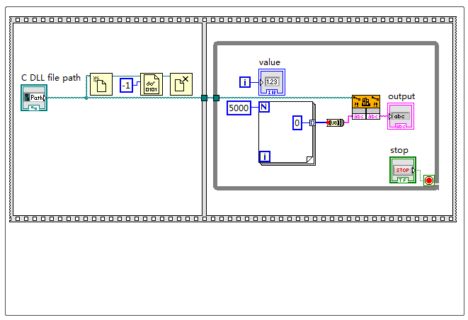

Then I suspect that maybe C# dll is deeply inserted into the software , not really DYNAMIC,so I tried hard to develop a C version "real" DLL file, and eventually finished.(now it seems there is no need to do as so , I can use any C DLL to test it).see as below:5.png
BUT , the same error still exits, showing "the file is already open".

Please explain to us what the purpose of the File Open and Read for the DLL is! That DLL is in a binary format be it a C# assembly DLL or a Standard C DLL. So there is really not much you can do with this file contents in this way.
DLLs are meant to call its functionality, not to access their contents as data file like this! Once a DLL is loaded into memory it generally stays in memory and Windows locks it, so that some malicious virus or user can't change its content under its feet and cause a crash.
Assemblies are loaded in LabVIEW when accessing one of its functions for the first time and stay then in memory until you unload any VI that contains a reference to them. Standard C DLLs are also loaded when first accessed and unloading them is only possibly when using the dynamic path of the Call Library Node AND making sure to call every Call Library Node that has a reference to that DLL afterwards with an empty path (e.g. to much hassle in general to do like that). Loading and unloading DLLs, be it .Net assemblies or Standard C DLLs is a VERY time costly operation so LabVIEW does not do this every time a DLL is accessed.
If you still think that this is a superintelligent thing to do, you should look at the open mode of the File Open node. It's default value is NOT compatible with accessing a file that is already open by someone else.
If you build an exe and start it it loads everything including the DLLS and then stops executing and unloading everything each time. Process creation and tear down in Windows is even more costly than loading DLLs so the additional overhead is not such a concern. In the LabVIEW IDE your program is just a script executed inside the LabVIEW IDE and the process remains fully alive all the time until you shutdown LabVIEW itself.
