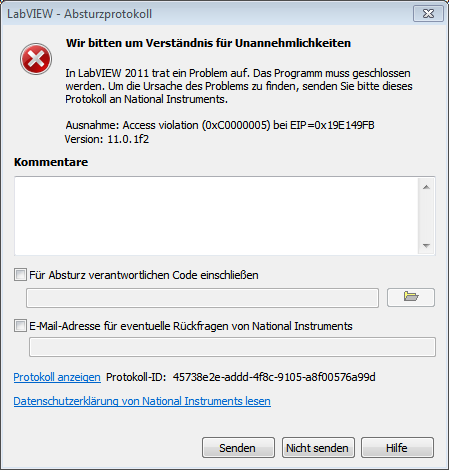

It is a crash where you get a dialog that LabVIEW had to be closed, because it generated an error. I can post a screenshot of the dialog tomorrow.

Here some more information about the crash
lvlog.txt:

12.09.2013 12:18:25.789
Crash 0x0: Crash caught by NIER
File Unknown(0) : Crash: Crash caught by NIER
minidump id: b611106b-f390-48b9-9634-41f4926b32c6
ExceptionCode: 0xC0000005
¥lqq€¡í
0x01AB6B29 - LabVIEW <unknown> + 0
0x01AB7068 - LabVIEW <unknown> + 0
0x7C37FDB4 - MSVCR71 <unknown> + 0
0x771E003F - kernel32 <unknown> + 0
0x77DA74DF - ntdll <unknown> + 0
0x77D69EC5 - ntdll <unknown> + 0
0x00000000 - <unknown> <unknown> + 0
Message 4 of 9
(6,066 Views)
Hello Dermot,
It appears the error you are seeing is a generic memory access violation- something (in this case it's pretty clear that it's the DLL you're calling) is overwriting memory already reserved for use by LabVIEW.   There is realistically not much we can do about that in this situation unless you have access to the DLL source, but I would get in touch with whomever provided you with the DLL and see if they are aware of the problem and determine if there are any caveats to calling the DLL - there may be some sort of built-in debugging or status tool that could be queried to determine the state of the library before reinitializing.
