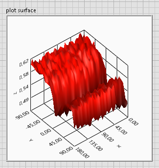

I need create 3D graph. I have polar graph and this polar graph (polar graph.jpg) I need trasform to 3D graph, but I have matrix 18x36 data. 36 is from 0 degree to 180 degree every 5 degree and 18 is count polar graphs. So I need this all polar graphs put to 3D graph, but this is problem. This polar graphs I need to rotate 10 degrees in X Y axis I mean (example.jpg). In (direction.jpg) is direction drawing polar plot.
I did it by this example https://forums.ni.com/t5/LabVIEW/Antenna-Radiation-Pattern-in-3D/td-p/2886874/page/3 but it is bad for me (my 3D.jpg).

honestly, I don't understand what you want to do - is this a   a functional issue - or rather an cosmetic issue?
 I guess we are talking about this section of your code (which I did tidy up, see attached 2018-10-30_graphs.vi):
you have this dataset (2d z-array created from I18.zip ‏15154 KB using the unchanged rest of your code)
and you want to plot it on a sphere.
therefore you create an additional  2d x-array and an additional 2d y-array
and plot it together with the 2d z-array to "plot parametric",
and set the 3d plot's coordinate system  to "spheric"
do you want to rotate the whole "plot parametric" around the z-axis, because it looks nicer?
or do you think, something is not working properly?
by the way, you should right-click on "path2" and configure the control like this, as you don't want to selcet a a single file
but rather a folder containing a bunch of files

I am sorry for late answer. I am trying this and make 3D graph for me. I created four 3d surface with Z axis 2D array and four 3D surface with Z axis 1D array. Every 3d surface was another because I changed X Y and Z. Combine every with every. I change too degrees from 0-180 to -90 to 90. In picture is what I thought.
Thanks for your answer you help me 🙂 🙂 🙂
