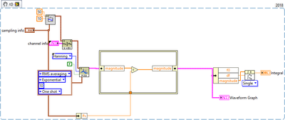

We are trying to study the PSD of a sine signal. We are finding that the magnitude  of the output of the PSD VI does not correspond to the value given by the math equation "A²/4" at the frequency of the sine (and A being the amplitude of the sine).
Moreover the magnitude of the output seems dependent on the number of points generated by the sine wave VI.
Can someone help us understand where this problem is coming from?

We seem to have a similar problem. We would like to generate the PSD of a sine signal. We notice that the frequency of the peak of the PSD seems correct but the value of the amplitude of this peak is far from what we expect for a sine. We notice that this amplitude changes when we change the number of samples of our sine.
We have also tried simulating a PSD by doing the autocorrelation + FFT on the sine and we have the same problem.
Please could you help us find a way to have a correct amplitude?

No we tried mcduff's suggestion but it didn't change anything. The problem is not linked to the units of the amplitude but the way it varies depending on the amount of samples of the sine signal.
We have tried using the autocorrelation and FFT VIs instead but we have the same problem (illustrated in the VI attached).
If you have any suggestions we would be very grateful,
Ella

The integral of the PSD should give you the total power in the signal. When you increase the number of points while keeping your sampling the same, you increase your time acquisition. This means the frequency bins are smaller. Thus some peaks will increase, some peaks will decrease, but the integral of the spectrum remains constant.
Different number of points different size bins. If you want the same magnitude for each peak irrespective of number of points, assuming same sampling rate, divide the magnitude by the number of points. To get the correct answer when you integrate you will need to add a scaling factor.
