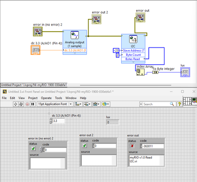

PROBLEM IN READING SENSOR DATA
Hello learners , I'm trying to acquire lux data from BH1750 sensor module using myrio, the module communicates through i2c communication. But I'm not able to complete the task it is showing error -363011 "myRIO v1.0 Read I2C.vi" as the source , but I'm using the predesigned blocks of myrio.
Can anyone help me with this error.

There's very little we can see from an image of a VI, esp. if it's an image of an express VI...
Express VIs usually aren't that convenient as they appear at first.
The error seems to indicate "Receives a No Acknowledge"...
LabVIEW myRIO Receives a No Acknowledge when Controlling an I2C Device - NI
