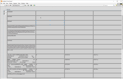

How to read .dbf file correctly?
I have a file with a .dbf extension and I need to read the contents of it, but it comes with unreadable characters
I don't have access to generate this file, I only receive the file and need to read and manipulate the file's data
How can I properly read this file?
(9,197 Views)
I read this data using Read Spreadsheet array , does it make sense ?
(9,166 Views)
This is binary file, the dbf extension usually reserved for dBase:
You should found spec for this format, read it as byte array and parse.
For example if this is dBase, then the first Byte is version, the next 3 bytes — date of last update; formatted as YYMMDD (with YY being the number of years since 1900), in your case 7B 09 0E which is decimal 123; 9; 14 - means 14 September 2023 (1900+123), the next four bytes is amount of records (it seems to be that you have attached the only small portion, or something wrong with your header/data).
Keyword in the header is DBWINUS0 - search internet you will found some viewers and specs like https://www.dbase.com/Knowledgebase/INT/db7_file_fmt.htm

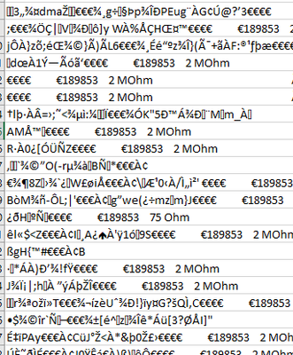

Yes, i'm doing like that
But i would to read the characteres correctly too
(9,155 Views)
Accepted by topic author leandrofeder
You can't read data correctly as long as you don't know how they encoded. Some text is readable:
But the bytes sequences like DA E2 BD D5 28 E6 etc cannot be visualized as "characters" without decoding, may be here some number stored as floats/doubles, may be something else. Again, it is binary and not text format.
