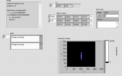

or let's use the python node to use opencv-python directly to extract the image data as numpy array and pass this array to LabView

I was able to observe the same dual exposure using the Python Script as well:
So, to clarify, I am trying to use the IMAQ functions to read in the image. So, if the image is U16 and the values are not being altered in Python, why does IMAQ rescale these values? How does it know to rescale?
