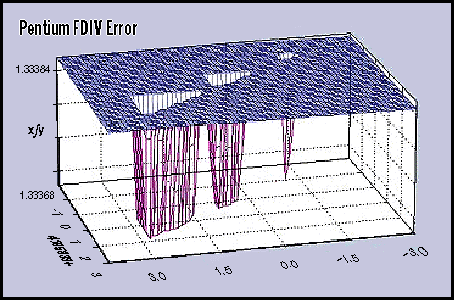

"But the FDIV bug is reproducibly wrong, ..."
If my memory of that issue serves me correctly, the diagnostic that was run to test for that flaw, looked for a certain number of errors out of some total number of attempts. But that is just my memory.
The main point I want to relay with that link is that FP errors will result in small "rounding errors" and that there are no checks inside the FPU.

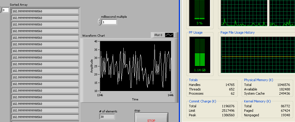

As mentioned, when this happens, it happens all the time (i.e. you can run the a VI which demonstrates this over and over, close it, open and it run it again and it will keep demonstrating the issue for a long time). When it doesn't happen, it doesn't happen, no matter how many times you run the VI. The key is finding out what causes the switch from a working state to a faulty state and I was hoping the workarounds I mentioned could help point NI in the direction of what might be causing this.
Whatever is causing this is not a simple thing, but it's also not something very esoteric, because I've seen it at least 3 or 4 times over the past several months.

NO, certain inputs reproducibly show the error. It was 100% deterministic, for example (from your quoted link):
4195835.0/3145727.0 = 1.333 820 449 136 241 002 (Correct value)
4195835.0/3145727.0 = 1.333 739 068 902 037 589 (Flawed Pentium)

OK it was a long time ago and I remebered there was some random factor involved.
This image
Is linked into the Byte.com article on this flaw.
So it looks like you are correct Christian in that the bug is reproducable. The chance factor affected how likely a random user would see this error.

That is interesting... In LabVIEW  7 I can't have a numeric conversion to 102.9999999999998560 but to the nearest is 102.9999999999998580
which hex reads as 4059 BFFF FFFF FFF6 while 103 reads as 4059 C000 0000 0000
So it is not a swapped LSB but the whole mantissa that is substracted by 10 (base 10!!) somewhere.
The precision quantum at 103 is 0.0000000000000140 which mean you ask one digit of precision more than what is numerically available. Does the problem occur with formats %0.15f or %0.14f?

After seeing this, I was about to say that it's possible that I got this wrong and that it was 80, but then I looked at the image I posted in reply 7 which shows this actually happening and it's definitely a 60, so maybe that's a clue.
