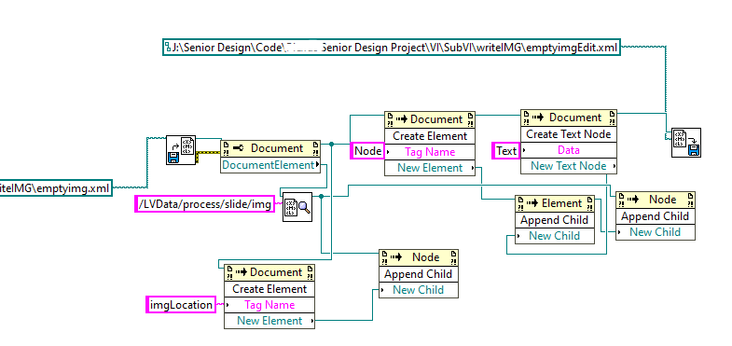

I'm trying to create a VI that can read in an existing populated XML, then add children to that node.
Here's the existing XML file. I want to insert children in "img" the same way that "font" and "verification" have children that hold data. All other solutions that I've looked at create a new XML file, and thus reference document types instead of node types.
I would like to just have the LabVIEW code point to the "img" node, then insert children, but it doesn't seem to be quite that simple. When I try to implement a solution, it appends a node at the end of the file:
and yields:
One path of the code successfully puts texts within a new child, and the other just creates a child.
I want to insert "imgLocation" under "img", and insert text within it.
I know my VI needs some overhauling, but can someone give me guidance?

A first comment on your code would be that you have two nodes being added, but they aren't linked by dataflow - that is, you don't know which of "imgLocation" or "Node" will be added first. I don't know without testing if the reference can end up with a race condition in which sometimes they aren't both reliably added...

Ah, after a little playing I found it.
You were close - the problem is at the "Get First Matched Node" - you've wired the Append Child methods to the "Node out" output, but you need to use the "node result" immediately below that.

Your modified example was exactly what I was looking for! The way I was thinking about how to wire the blocks was all backwards from the "syntax" that LV wanted.
Thanks much.
