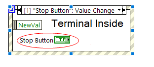

  1. Typically there is only 1 Event structure in a VI that handles UI Events. I do use multiple Event Structures within 1 VI, but 1 loop typically only handles User Events, not UI Events.
  2. It is typically good practice to include the terminals of your controls within the Event Structure as opposed to outside it, although there are obviously exceptions. (See Below)

I have always wondered about that. Does it matter and why?
Could that explain why my tab control is sometimes one click behind the radio buttons?
What if you need the value of that control in more than one event case? Should I use locals or place the terminal outside the structure and wire it in?
