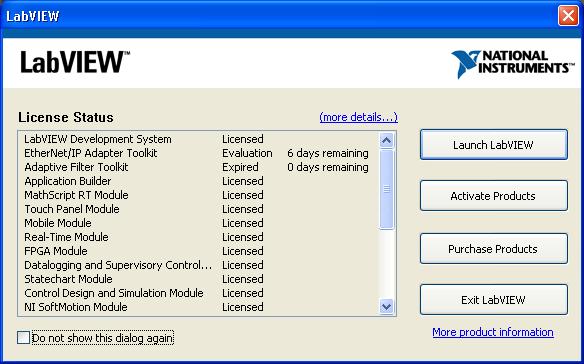

Yesterday I installed the "NI Industrial Communications for Ethernet/IP"  version 1.2.1 on my LV 2010 machine (customer using 2010 so other version a no-go).
Since NI could not find a number for that toolkit they could not give me a quote so I had to install it as an eval. I figured OK for this week.
Today when I opened the project that uses that toolkit LV promptly exits, no not a crash nothing in the crash logs folder.
Here are the images and narative;
Open LV 2010... I can see I have 6 days left.
Click Launch LV and get option to extend where I select "no".
I can see LV try to open the project but then...
LV promptly exits.
If I do NOT open a project that uses the toolkit, LV opens fine.
If I try to extend the Liceinse phones home and promptly dies.
I have logged SR #1895441 and have pushed to get this fixed.
Is anyone else having trouble with the eval for add-ons?
Ben
