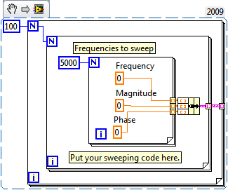

I was just having a hard time understanding how everything was going to work. Now i know that I want to take a full set of measurements of magnitude, phase and frequency at every location on the grid.
Message 13 of 75
(3,386 Views)
In that case, you will want to write your sweeping code so that it collects the data over every frequency that you want to test (possibly using a for loop) that has your acquisition code.  It would be best to take those arrays and bundle them into a cluster.  Then you will do that 10000 times going through points (0,0) to (100,100).  This will create a 2D array of clusters that contain 3 different arrays of your magnitude frequency and phase.
19693iB46710589096544B

Do you think this will work:
19695i19A74E03EFEA4FD9

Well, it seems you decided to put what you want the output file to look like in another post. It's best to help when everything is in one place. That will not generate the output file as you showed in the other thread. Appending to an existing file appends vertically, not horizontally. What you'd need to do is to pre-allocate the 2D array and then replace the sections in the 2D array as you collect the data. Or, you can read the contents, play with some array functions, and append the new data. Kind of depends on how much data you're collecting. How many points are you collecting per sweep?

Hold on, are you sure that's the format you want? For a grid of 100 and 200 points per sweep that would mean a table of 200 rows and 30,000 columns. Planning to import this into Excel (your .xls extension seems to imply this)? If so, you won't be able to. Excel 2007 has a limit of 16,384 columns. Not sure about Excel 2010.
