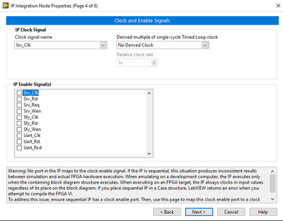

I wish to integrate an IP Core that was provided to me in VHDL file format to LabVIEW FPGA. I can correctly setup the IP Block up until the clock setup page and if I select no clock, then it proceeds normally. Although, I need it to run on a derived clock 100Mhz so it must take clock input of my SCTL, 100Mhz.
Last night when I was setting it up, I was getting message stating that the clock enable pin is missing. I also came across some posts that talked about something similar. However, I can not come up with a way to apply the same in my case. This IP that I need to integrate, I am calling "Fancy_IP_Core", has 3 components in it that require a clock input. To simplify this, I have later created a top level VHDL code that is applying a  single clock of 100Mhz to all 3 inputs. This clock in VHDL is generated by a clocking wizard using VIVADO 2022 tool. It completes all runs in VIVADO and generates a bitfile but I am not sure how I can transfer this VHDL code to LabVIEW. I know LabVIEW requires VHDL files from older VIVADO versions my only concern is with clock wizard related file as rest is basic code.
This morning when I tried again, either I missed a step or I changed something but I am not getting a clear message about clock enable pin, maybe I remembered incorrectly. But below is the current message:
"One port maps to more than one type of clock signal. The clock signal, derived clock signal, and enable signal must each be mapped to different ports in the IP." Please note that in this window, I am only using "Fancy_IP_Core" files without my top level VHDL code. This is to avoid any errors at my end.

Adding information, I found the same message again and upon careful reading I have another question, do I even need clock enable pin?
The clock pins SRV_Clk, Sfy_Clk and Uart_Clk in the IP does need 100Mhz clock signal. How can I provide it?
Message below:
(1,787 Views)

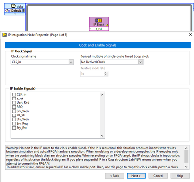

Hi Terry_ALE,
Thank you for responding.
Okay. Trying to come to a better understanding, if I simply place it on the block diagram, what will I be connecting to the clock pins: SRV_Clk, Sfy_Clk and Uart_Clk?
These pins drive rest of the code. Or should I create a top level VI and then have 1 clock signal routing to the rest and then select this one clk pin as a clock input in the IP Integration window?
I would really appreciate if you could clarify this.
N
(1,766 Views)
Okay, I implemented the concept I talked about and named a single clock pin CLK_in. Selected this as a clock input pin and it appears that LabVIEW is now sending clock pulses to it. Which then routes it to rest of the logic.
I know have two more questions:
1) Does this approach sound correct to you?
2) I now have a tiny caution sign on the IP block, it is safe to ignore it and how can I see that it is cautioning me about? Is the basically pointing to the warning in the IP Integration node properties window?
(1,753 Views)
This thing worked!!!! In my case this is the solution but I would not want to mark it so. I feel weird marking my own post as solution. Terry, I appreciate your suggestion, if the logic did not require a clock input pin your suggestion would be the solution.
