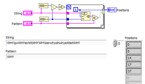

Naive Algorithm for Pattern Searching
Is anyone doing this in LabVIEW?
https://www.geeksforgeeks.org/naive-algorithm-for-pattern-searching/
just curious.

Use the "Match Pattern" primitive.

Just another possibility....
Message 3 of 11
(2,959 Views)
i overlooked (n-m) +1 ... 🙈
Message 4 of 11
(2,942 Views)
That works! Thank you!
