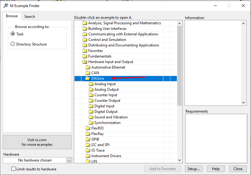

Good that you shared snippets and VI.
Correction, it is not NI Device monitor, it is DAQmx soft front panel or test panel for that device.
Next, you're using ULx drivers for NI DAQ. FYI - ULx drivers are for Measurement Computing devices and DAQmx is for NI DAQ devices.
Not surprising that you could not select the NI 6009 in the drop-down as you were using an incorrect driver.
Please rewrite your code with DAQmx drivers available in the Functions palette as shown below.
I would highly recommend going through some DAQmx examples as your implementation could be better refined for stable functioning.
Help>>Find Examples
