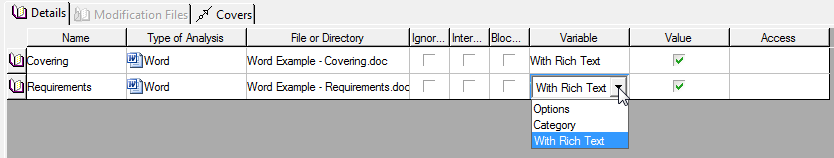

Looks like what I needed. But my example project looks differently, like this:
And enabling "With Rich Text" variable doesn't help.
Any suggestions - what else needs to be enabled or configured?

Well, finally got it. Just manually added the following lines to the *.types file:
Variable1Name=withImages
Variable1Label=With images
Variable1Type=boolean
Variable2Name=withCharacterStyles
Variable2Label=With Character styles
Variable2Type=boolean
Variable3Name=withBookmarks
Variable3Label=With Bookmarks
Variable3Type=boolean
Variable4Name=withAnnotations
Variable4Label=With Annotations
Variable4Type=boolean
Variable5Name=tabCellsFolding
Variable5Label=One Cell Per Line
Variable5Type=boolean
(They taken from Reference Attribute and Filter example)
Now I have pictures in my report:
Strange that these variables aren't available by default when Word type is selected (user manual assumed that they should be there), but anyway trick with manual modification *.types file does the job.
Another way to get this - just copy/paste Maturity Level type from Reference Attribute and Filter example - this also works.
