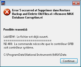

Thanks for the answer...
My Os is Windows 7 Professional SP1 64bits.
I have exactly the same problem runing MAX as admin...
I also tried to replace the complete C:\Program Files (x86)\National Instruments\MAX directory from a computer where MAX runs... i have the same result.
Finally i tryed the MAX Database Corruption Removal Tool and i get an error when the tool tries to delete the directory C:\ProgramData\National Instruments\MAX\Data.
