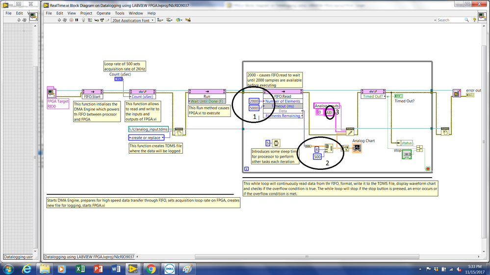

I am new to LabVIEW FPGA. I am using cRIO9037. My project is to acquire data for multiple analog modules NI9215. Sampling rate 2KHz. I used the examples to build the template. The example program which acquires data from 1 module (4ch) works well, however when I try to add on other modules (all the modules are NI9215), I am not able to figure out the changes that must be done. What changes should I make? Can I get a help over this?

Oh!! If you could help with the screenshots - Attaching the screenshots of FPGA.vi and RT.vi.

OK, so at (1) you are allowing a wait of 5 seconds to have 2000 elements in the DMA FIFO sent from the FPGA.. This is OK as long as we change something else 🙂
At (2) We are grabbing 2000 elements from the FIFO and converting them to double precision float data.
These elements were multiplexed from the different channels in the FPGA, so the data goes like this
1st sample from MOD1\AI0
2nd from MOD1\AI1
3rd from MOD1\AI2
4th from MOD1\AI3
5th from MOD2\AI0
6th from MOD2\AI1
7th from MOD2\AI2
8th from MOD2\AI3
9th from MOD1\AI0 again
etc............... up to 2000
We need to decimate this back up into the correct channels. So we see at (2) that we reshape the array into 4 lots of 500 elements. This is bad for you since you want 8 lots of 250, because thats how you packed it into the FIFO on the FPGA end.
Should be simple enough to remedy by changing the 2 values.
At (3) there is an array, im guessing its just 4 elements with the channel names for the TDMS log files, you will need to add more to this so the array has 8 elements, one for each of the channels.
Hope thats clear but let me know if you're lost.

At (1) you are specifying that you want to read 2000 points from the DMA FIFO. You populated this in the FPGA from all 8 channels.
The order of elements who live in this array is:
mod1\ai0
mod1\ai1
mod1\ai2
mod1\ai3
mod2\ai0
mod2\ai1
mod2\ai2
mod2\ai3
mod1\ai0
mod1\ai1......... etc up to the 2000th element. Since this is how you packed them in on the FPGA.
However at (2) you reshape the array, essentially decimating the data back into "per channel" data from the interleaved data you created in the FPGA, thi is where the first problem is... You are reshaping it into 4 channels of 500 elements, wheras you the data actually is comprised of 8 channels of 250 points each.
An easy fix by changing them 2 values.
At (3) you have an array of channel names for the TDMS logging. This will only contain 4 channels, but you need it to contain 8 so your data get written to the correct place.
Hope this helps.
