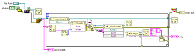

I am having an issue here with 2D arrays as well. Here is what I am doing.
This method used to work for active X:
What am I messing up here?
I do not get anything out of the Value2. I am getting an error 1172 which seems to be the go to for anything you are having issues with in .net. I'm not getting an error out of the Value2 property. I am getting the 1172 out of the .net to variant. Here is the error I am getting:

First step would be to wire that Variant to an indicator on the front panel. And then enable "Show Type" in the popup-menu. This will show you what the Variant knows about the internal data type it contains. From there you might have to do a specific conversion to make it work.

It shows up as void. So I have to be doing something wrong before this. I am calculating a range (A1:AO414) and that seems to be working correctly. Can you give me another clue? I don't seem to be getting anything from the get range function. Is there a different or better way to get the worksheet ref? I am guessing that is where my problem lies.

I can ask for a single cell and I get the correct response. When I ask for a range I get nothing.

Not sure if this helps or not, but maybe you're using an invalid range. AI tells me that Excel Interop uses 1-based indexing, so you should start the range from Cells[1, 1] instead of Cells[0, 0]. Just an idea...
