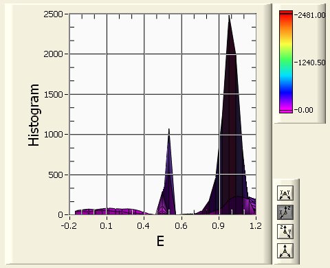

I am 200% with elset191 on this one. I am totally infuriated by the replacement of a relatively OK tool (the CWGraph3D) by a series of maybe native replacements, but nonetheless unbelievably buggy replacements.
In addition to some of the bugs reported above, what do you think of this series of snapshots:
for a starter, the E Axis orientation is not what I was expecting it to be from the 3D view. OK, no problem, let me edit the axis (at run time):
Oops! There was no autoswapping of the bounds when you type the former lower bound as the new upper one.
All right, I'll type in the lower bound:
What the !@##$#%^$%^%&%&@#!@#!@! !!!
The axis is now fine but the graph has not budged compared to situation 1!
These objects are absolutely useless!

OK, so I owe somebody a BIG apology...
The symptoms I was describing above (non swapping axis boundaries) were in fact due to a classic mistake: you read 1.2 on a control (axis in this case), and you think "1.20000000000000000". Well, wrong! It might actually be 1.19999 or even 1.16, depending on the precision of the display.
The behavior I was describing above is one of these examples.
So this in NOT a bug. I am slapping myself in the face right now. It is an annoying feature of finite precision display, but once we've can learn to live with (or patch programmatically).
