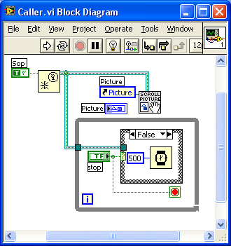

How did you create the stop reference.
Here are two options - the bottom one can be used to access the same event reference from any VI, so that you don't need to supply it as an input.

I think I am going to love user events. If I create a user event like stop. Can I use it in different vi's like this.
Main UI create the event.
Subvi's called dynamically or regular listen for the user stop event.
This way when I close the main vi all subvi's will close.
If this is the way that it works, this will be great. I can implement this functionality into my current project.
Thanks Guys,
Joe.
