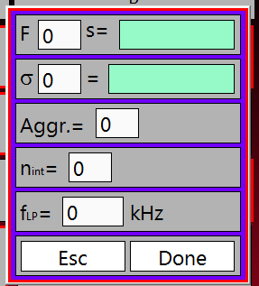

Modal window has a annoying grey border around when running
When I open a sub-VI with window appearence set to be "Modal", a small grey border appears around it. Is there a way to get rid of it?

I don't think so.  I might be wrong but I think that border is built into the OS and is defined by the theme set.  If this is the case (and I'm not certain it is) a low level Windows DLL call can probably remove it.

The border is the widnow style of a modal.  It's defined by the OS, not LabVIEW.  No way to remove it in LabVIEW.
