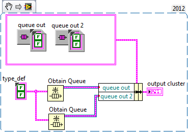

Ben and everybody else
Thank you for this article + discussion. This was something what I was looking for.
I need this when I have got more queues in one cluster which is distributed to all corners of application.
I am attaching screen shot of my "implementation"  (LabVIEW 2012).
Queue ref auto update

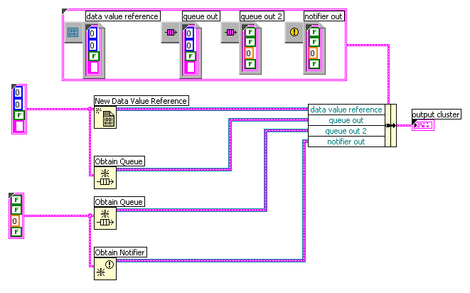

Eureka!
Auto-update reference is working for:
  • Queue
  • Notifier
  • Data Value Reference
one more screen shot:
