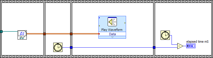

I've just started using LabView and I'm working on a project in which a sound file needs to be played once a microphone picks up a sound with a frequency above a certain level (I have a sound board right now that allows me to manually make these cues). I'm sure I'll have many more questions in the future, but for right now I was just wondering how I could measure how much time it takes for LabView to read the frequency and then play the file.

You can get start time and end time by using Tick Count (ms) Function or Get Date/Time In Seconds Function.
Hope it helps!

I tried a similar setup on one of the templates but I got everything from 2.3 ms up to 109 ms. What are you using to break up the steps in that example?

Sorry I'm being that annoying new guy in the forum who just posts questions as he thinks of them and doesn't bother doing work. I figured out the issue and everything seems to be working. I'm consistently getting readings of around 330 ms. Does that seem correct? Seemed a bit slow to me.
Also, out of curiousity, what is that item you're putting the final value into at the end of the process? I've just been using a numeric indicator.

lvABC - I like your method of measuring time elapsed. How would this be done with Labview RT? The TickCount block only returns time in msec.

BenYL,
One quick way to get time output would be by using shift register.
Message 9 of 13
(6,496 Views)
Also- check out the elapsed time function on the timing pallate- Smiley Wink
