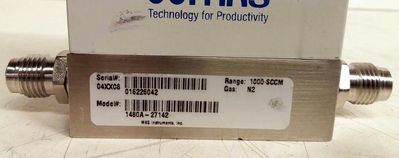

Thanks for the answers
Buying that MFC was a mistake and waste of time and money.Also that was the cheapest one (100 $).
I wish I could control that MFC but it seems expensive and time consuming. So I should buy another MFC. But if there is any other way to control this MFC using LabView and a NI USB 6008 DAQ please tell me. Here is my MFC:
If there is no way, so which type of MFC should I buy?
9 pin or 15 pin?
Message 47 of 76
(5,135 Views)
I beleive, there is no way to control a DEvicenet interface using a DAQ USB-6008.
"If there is no way, so which type of MFC should I buy?
9 pin or 15 pin?"
Both should be ok (you will just need a different D-sub socket to make or buy), but be sure and double check the manual before you buy. You need a MFC which can be controlled using 0-5 V voltage signal, and creates an analogue output proportional to the actual flow rate (between 0 and 5 V DC).
The best if you post here the model which you find, so we can have a look.
Do not forget, you will also need a proper power supply with DC voltage inside the required range specified in the MFC's manual. Also be very careful when you do the wiring, you can damage your MFC if something wired incorrectly.
EDIT: another option which you can consider is buying a MFC with RS232 interface. Many MFC has RS232 pins beside the analogue control/read option. Either you have RS232 (also called "serial port" often) already in your PC, or you can buy cheap USB-RS232 converters (few EURs, try to get models with FTDI chip, usually they work good with LabVIEW). If you get an MFC with RS232 interface, you even do not need the USB-6008 to use. You simply use RS232 communication between the PC and the MFC. Many MFC models have LabVIEW drivers available for RS232, but even if not, using the manual, you can figure out the serial commands which you need to program in LabVIEW...
But still, you will need a power supply (PSU).
