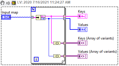

Map Variant to Key and values arrays
Does anyone know how I could create an array of keys (as a variant) and an array of values (as variants) from a map variant.
I would imagine it is possible to do this by parsing the out of variant to flattened string but I currently cannot make sense of the help file for this.

So are you looking for code that takes an arbitrary map and outputs all of the keys and all of the values for that map?
Message 2 of 13
(4,982 Views)
I'll assume that's what you want 😉
Here's some code. The trick is to use a malleable VI (.vim) for the arbitrary map input, not a variant.
Message 3 of 13
(4,980 Views)
In my implementation the maps datatype is unkown (It is already a variant) so your implementation isn't quite what I am after.

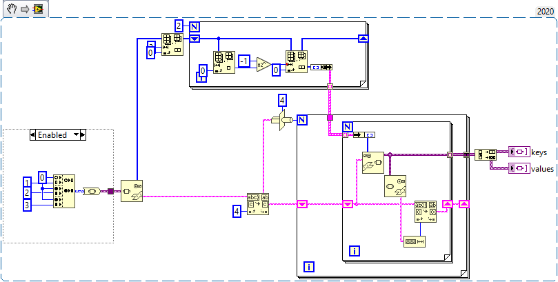

After a day of banging my head against a wall I have worked out a way of doing it though
I am open to better ideas as this is incomplete and won't handle all data types atm.

That is what I started out with as well, I found it got more complex when you start to handle strings, paths and arrays where there size is prepended before the data in the flattened string.

Accepted by topic author Worle
It still works?! (Seems pretty solid to me?)
EDIT: Even map values:
