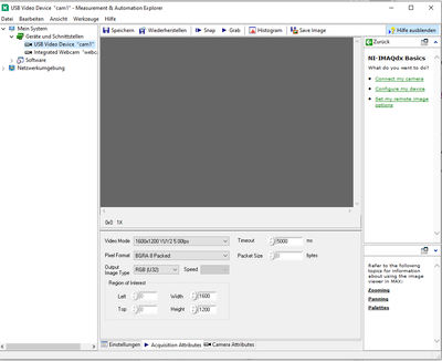

I wanna record and save a video with my Logitech C270 when a certain value changes. For that I've created the VI in the attachment. The VI just works fine with my internal laptop camara, but when I want to record with the webcam, the fps drops significantly and I don't know why. I've already checked the different codeds to use and for driver issues in MAX.

Adjust your Acquisition Attributes in MAX and save them according your needs.

Try'ed several different settings and lowering the resolution, but it didn't help. As u can see in the VI I've posted, I record picture by picture in a for - Loop at the moment. Maybe this could be the problem?

Have tryed it with a generic 1080p cam and now it works properly.
