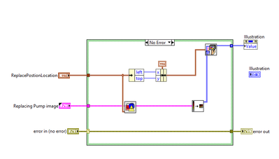

2D picture control doesn't refresh if it is out of the active screen
In my application I have used a 2D picture control to display Process illustration in picture based GUI. Based on user events I update the illustration, like when a user turns on a pump, then I replace the grey colored pump picture clip with green color pump picture clip on the illustration. I have to do this some times when Illustration is not visible on the screen(for example user turns on the pump in some other settings window). Then if I come back to the illustration screen, the illustration is not updated(I still see the grey color pump picture though pump is turned on in the Settings screen). In this scenario, I have probed the Illustration.Value input wire and the probe value is green color pump clip is passed to the picture control with proper coordinates.
I see this issue when illustration is out of the active screen. If illustration screen is active and visible then I don't see this issue.
I have referred this discussion and tried out the suggestions, but did not help.
I am using LabVIEW 2021 64bit on Windows 10.
Has some one experienced this? Please write your suggestions here.

Your attached picture does not illustrate the problem. Can you attach a small set of VIs that reproduces the problem so we can test?
