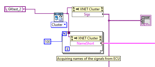

I am able to log data into the tdms file, but the data comes untitled (as shown below). I tried using a property node, it is still not working for me. Maybe, I am doing something wrong. Can someone please help me?
Thanks in advance.
I attached my VI .

Okay there's lots wrong with this code.  Have you taken LabVIEW training?  If not check out some of the free training online.  During the lock-downs, NI has put lots of their training online for free.
Your loop is running 100 times, with the same scalar input value.  This is not getting the signal names, but instead getting the cluster name (the input you provided) 100 times.  The single cluster name doesn't change and so you have an array of the same 100 things in it, none of which are the signals.

Lets ignore the 0 iteration for loop, it is probably a test.  You are writing to an array indicator, then reading that array indicator and using it as the Channel names.  This is a race condition and you can't guarantee it will read from the array after writing it.  Use data flow to ensure the data is updated.
Also as mentioned if you ran your code for 10s you will have 100 columns, 40 rows, and each waveform will have an unknown number of data points in it depending on the transmission rate of the CAN data.  This will call the write function many times likely with no data.
I also saw you weren't closing your XNet session.  This can lead to memory issues, and access issues if it is ran multiple times.
Attached is a simplified version that I think works.  It just grabs the first 100 signals from the database to read.  There is potential for memory issues since the waveforms will keep getting appended until you stop or run out of memory.  A better design might be to write data to a file once so much data has been read.  Then after you press stop (or an error happens) the loop stops, we create the file, and write it with a single write function.
