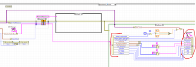

Hi Hooovahh,
I started to write application to parse the BLF file which shall contain CAN and ETH messages.
For CAN messages, it works like a charm.. Kudos to you!
when it comes to ETH messages, there is no implementation and started to define the message structure; but LabVIEW crashes the moment it tries to parse the ETH object. attached the type def that I created based on the .h file snippet here.
Do you think I should create a cluster with 1600 u8 numeric? or how to handle the "BL_LPBYTE" data type?

I am not able to attache the ctl.. so here is the snapshot of the same,

Sure, I agree with you about the datatypes creation for DLL, unless the DLL creator has a very good documentation.
However, i was able to create the typedef for the ETH frame. The update made was creating a cluster of 1600 elements of u8 for the payload part of the class.
The blow is the code snippet and the ETH type def.
Now no more crashes and still validating the packets populated. I shall keep this thread updated about any further development.
