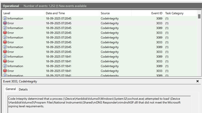

Hi
Maybe another view on this issue may help.
On this updated W11 23H2 computer I have only LabVIEW 2022 Q3 installed as newest.
And System Configuration 2023 Q4. The computer has no undesired behavior.
But the Event Log for CodeIntegrity shows problems. An 'endless' number of the same two failures :
Code Integrity determined that a process (\Device\HarddiskVolume3\Windows\System32\svchost.exe)
attempted to load
\Device\HarddiskVolume3\Program Files\National Instruments\Shared\mDNS Responder\nimdnsNSP.dll
that did not meet the Microsoft signing level requirements.
attempted to load
\Device\HarddiskVolume3\Program Files\Keysight\IO Libraries Suite\LxiMdnsNsp.dll
They can however both be 'captured' by two different mechanism in the Microsoft checker.
Either as shown above or like this :
Code Integrity determined that a process (\Device\HarddiskVolume3\ProgramData\Microsoft\Windows Defender\Platform\4.18.25070.5-0\MpDefenderCoreService.exe)
attempted to load
that did not meet the Custom 3 / Antimalware signing level requirements.
I have no idea what Microsoft 'signing level' refers to. Only Microsoft software installed.
Now the interesting observation here is that both offending DLLs are related to Apple Bonjour.
One is the NI mDNS version and the other is a Keysight mDNS version.

On this computer I also have the original Apple Bonjour service running. The DLL is very old :
