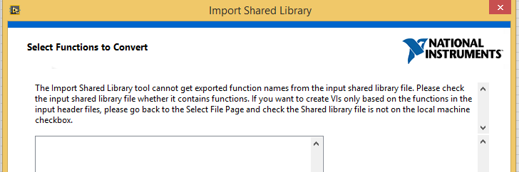

I am suffering about linking a DLL into LabVIEW. I am using LabVIEW 2014 32-bit and generating my DLL in Visual Studio Express 2013. I am using Import Library Wizard (Tools->Import->Shared Library), I select DLL file and header file, I click next, and getting error "The Import Shared Library tool cannot get exported function names ....." as pictured below.

If I select I get only 3 functions, the function Addition is not listed as pictured below:
And of course it does not work.

I've you tried to disable the name mangling when compiling your *.dll?
Michel

In my experience, I have instantiated my class in global space and wrapped the object's class methods inside global space functions as shown below.  And when you build this, make sure you tell your compiler to set the BUILDING_EXAMPLE_DLL flag (i.e. CXXFLAGS   = -DBUILDING_EXAMPLE_DLL)

Have a look at this whitepaper: http://www.ni.com/white-paper/3056/en/ for building a C++ dll. The example code is helpful too.

LabVIEW cannot do anything with a C++ class in a DLL, including import functions contained in a class. Any function you want to call from LabVIEW must be a standard C function. You need to rewrite your DLL without classes, or wrap the classes in standard C functions.

Thanks, I followed that white paper, I deleted class and implemented everything as C functions, it works now.
